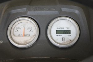

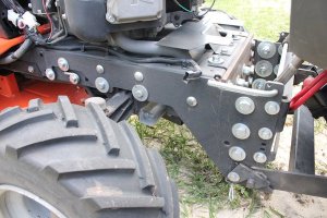

Yesterday, 15MAY2020, I passed the 200 hr mark since I reinforced a new TS chassis.

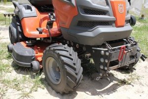

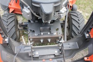

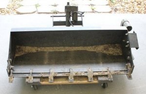

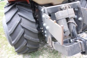

I just want to let you all know that the rebuild is still working and working well, solid rebuilt chassis, 200 hrs of actual Garden Tractor use later. I have zero hesitation in it's ability to dig in the dirt (or sand).
I want to offer hope and encouragement with this post and the continuous proof that a fourth option not only exists, but is solid, may cost what you would pay the Dealer, but you will get a tractor that is so much more. If you are here or find yourself here eventually.

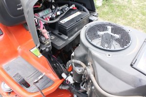

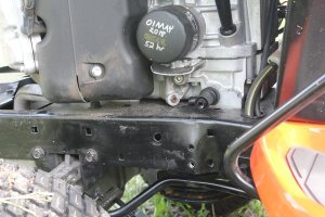

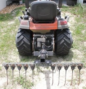

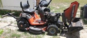

I started here at 63hrs, June 2018 (purchased new July 2017).
I ended up here,
The GT as of 15MAY2020, ran the blower over it, cleaned the filter, getting it prepared to rake pine needles, and mow the grass.
Some more enhancements for this type of GT are on their way in the near future.
