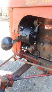

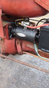

I had put a new GM internal regulator alternator on my Pony but I didn't like it shining like a new penny and it seemed to be shouting "Hey look at me I'm a GM alternator" so I disassembled it and painted it flat black. The starter needed a new bushing in the drive end so I replaced the bushing and painted the starter black too. I stripped the red paint off the solenoid and left it bare, as it should be. I think they both look a lot better.
I plan to order a new data plate for the Autolite starter and the upcoming complete rewire will take care of the sh***y looking wiring on it now.
The push-button starter button picked a great time to fail. Actually it stayed "engaged" because I replaced the line from the engine to the oil pressure gauge, which is right above the switch, earlier and forgot to tighten the line at the gauge. So when I started the engine oil squirted onto the switch. It took a couple of days in the warm (70+ degree) sunshine for the oil to soak into the switch, but by the time I got the starter back on and hooked the battery cables up the starter began to turn as soon as I connected the second cable. I was scratching my head trying to figure out what I had done wrong to the starter, or solenoid. I removed the starter and solenoid twice and disassembled everything trying to figure it out before I remembered the oil line disaster a few days ago. I checked the switch and sure enough, it was staying engaged even when the button was not pushed. I would have kicked my own butt except I am partially handicapped as a result of a serious accident almost two years ago and cannot kick high enough.
