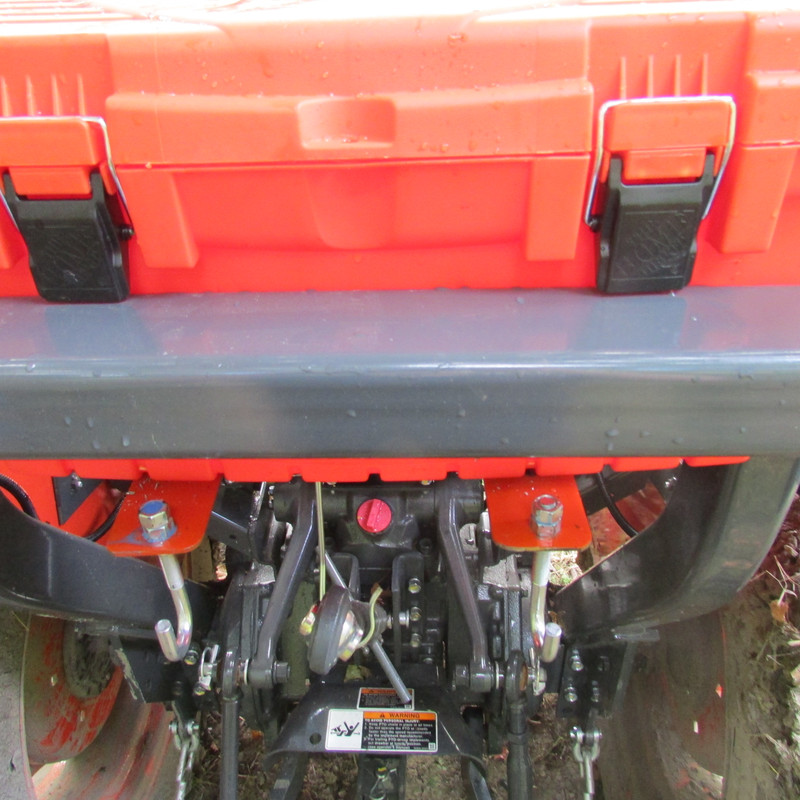

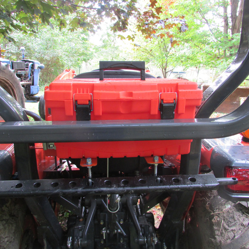

Kubota put this little box on it and called it a tool box. I have lunch boxes bigger and some pill boxes just a little smaller, seen just to the right of th SMV placard.
Got a tool box and the color matches a little even. cut some brackets for the inside and outside. I do have to modify the SMV placard some, but that isn't a big deal.
I put two of these hooks on, one to each bracket to hang things on one of which it the draw bar for thr 3 PT.
Draw bar hanging on hooks.
As you can see the latches are tight with the ROPS bar folded down. I will make some pull tabs for those latches.

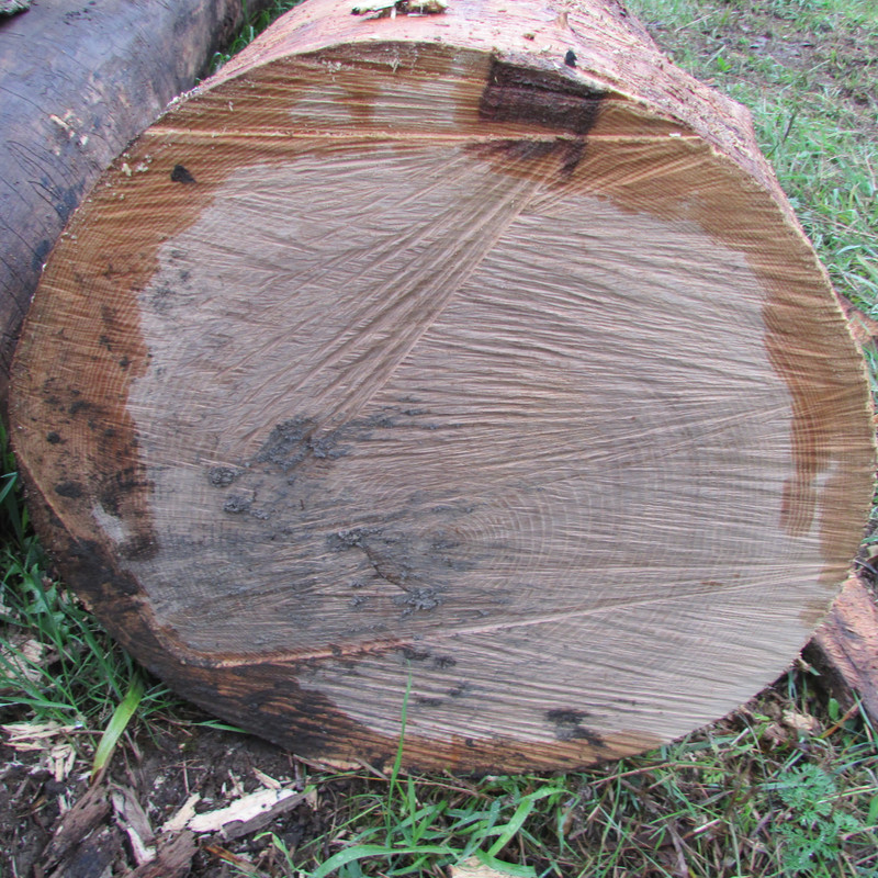

Yesterday one of those dead Ash trees got me. It was surrounded by some decent elm trees as I did the walk around trying to decide if it had a lean to it. I decided it had a slight lean to the south so cut my notch. when to the oppsite side and started cutting. Didn't go in far and it cracked and pinched the bar.
I had been about to remove the saw and use the sledge and wedge to make it go. Notch was to big to use the wedge on that side. Only one thing left to do at that point, get the Jred and cut a new notch above the stuck saw then cut on the back side of that notch and remove my stuck saw.
Every thing came out as planed that time. I have 2 left in that area to take out and about another 10 to 12 left total in the woods.
