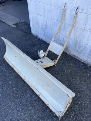

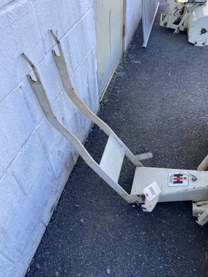

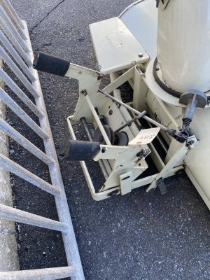

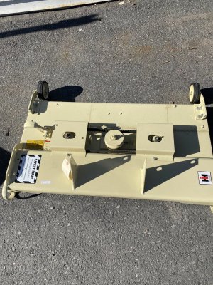

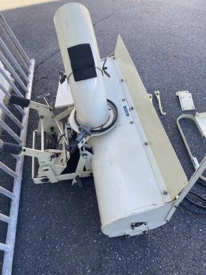

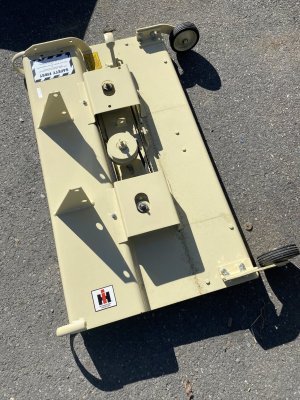

I see some IH Cub? attachments at a auction and wondering if somebody could tell me what they fit.
The snowblower is 42" wide.
The snow blade is 54" wide.
The mower deck is 40" wide.

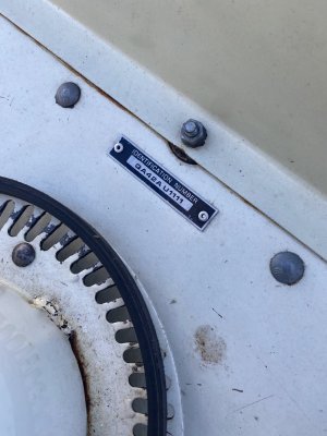

All in like new condition. Pictures below. Only tag I could find is on the blower..
2023-02-13_09-56-36_087.jpg 2023-02-13_09-56-31_730.jpg 2023-02-13_10-09-14_346.jpg

The blade should fit any wide frame tractor, 1971-mid 90s Cyclops series. 54” ones are not as common as the 42” version, and are usually quite a bit more money. If you can get it cheap, grab it. The deck is a 38” timed deck for an Original. Not 100 percent sure on the snowblower, but I think a QA42A is adjustable to fit a narrow frame or wide frame with the quick attach setup, which started in 1967 with the 1x4/1x5 series.

Thanks for the reply.
They're in like new condition is what made me look at them a little harder so made me wonder if they're for older tractors as such... The mower deck "almost" looks like it was never used...
