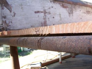

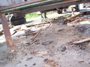

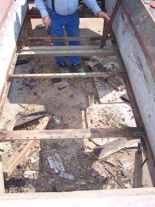

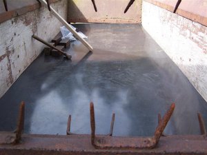

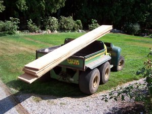

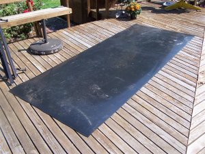

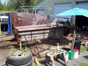

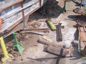

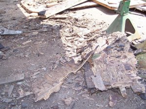

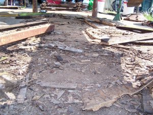

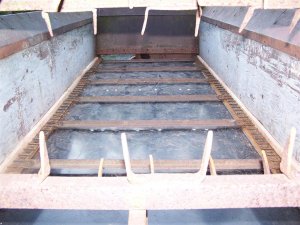

We put a new floor in this spreader about 25 years ago and now its time to do it again. Dad needed some help with it so I got out the sawzall and cut the old floor out while he used some bolt cutters to clip off the rusty bolts. We have some new fir boards that we cut on our bandsaw mill to replace the plywood and that will be covered with a heavy plastic sheet made just for that purpose.
100_0038 (Medium).JPG100_0039 (Medium).JPG100_0040 (Medium).JPG100_0041 (Medium).JPG100_0042 (Medium).JPG100_0043 (Medium).JPG100_0044 (Medium).JPG

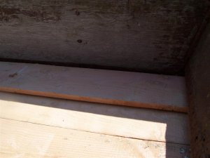

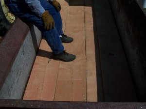

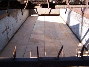

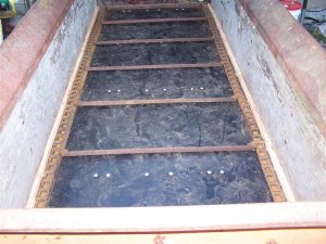

The plastic sheeting is trimmed to size and boards are all fitted and treated with a preservative. Now lots of drilling and bolting.

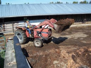

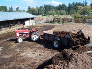

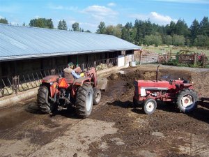

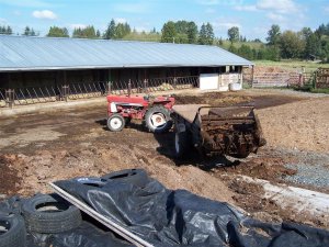

The spreader got its first test yesterday. Everything went well so we'll keep going until the bin is empty.

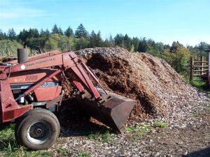

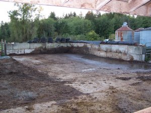

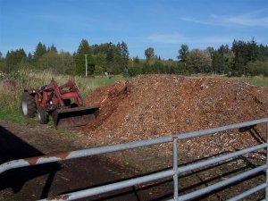

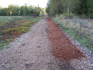

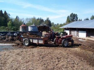

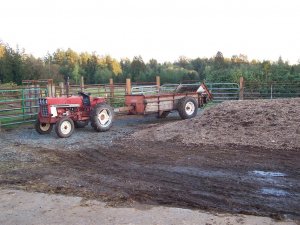

The last load of manure was hauled out yesterday. Now it will be used to spread Cedar chips on the cattle lane. Got the first load on today.
