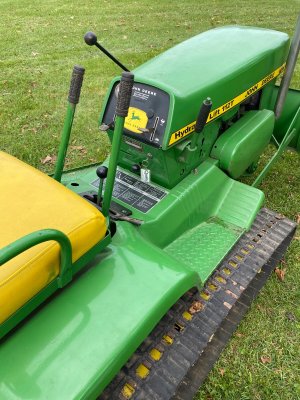

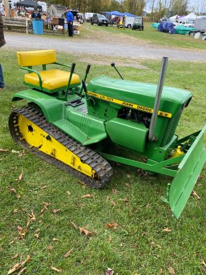

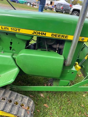

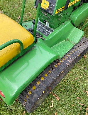

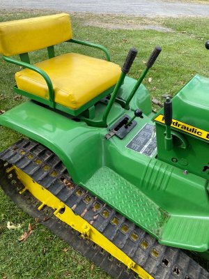

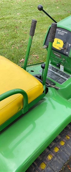

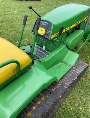

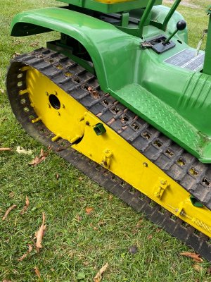

Seen this at a local swap meet and thought you guys enjoy.
Talked to the guy and said it’s homemade ( not by him) and that he just takes it shows .
Interesting piece. The guy I’m assuming he is semi local to me and possibly Jake even knows of this fellow. I will say I was watching him move around and he was careful how he turned due to maybe the tracks coming off. All in all pretty nicely done.
View attachment 99525View attachment 99526View attachment 99527View attachment 99528View attachment 99529View attachment 99532
That's a new one on me, Bill. Looks like the tracks are a little short for center of balance, looks like he has a caster wheel under the front to hold it up, especially with having the blade hanging off the front. If he went with a bigger front idler, he could have gotten away with a half track, probably wouldn't turn as sharp as having it full track. If he put a full rack of weights on the rear he might be able to do away with the caster wheel. He probably got a well used set of mini excavator tracks, hence the short foot print and going easy with it.
