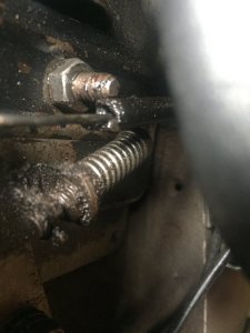

Yours will probably look a little different depending on what machine it's in but the shaded pieces in the picture are the same and what you need to adjust to get a higher rpm

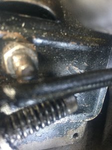

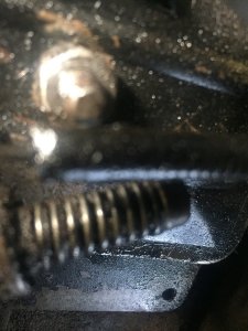

Some pictures of the one I adjusted on my JD 140. Hard to get a good picture.
