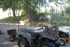

Got a hunting lease on the 160A right outside my back door. All non timber ground is in a Conservation Reserve Program and seeded down with a pollinator type seed. Has lots of wild flowers along with a variety of grass seed. This year the flowers are thick and 4 - 5' high. Due to this ground being in a govt. program I cannot make a definite path through it and getting the ladder stands back up to the furthermost tree area was going to be a problem. Only access short of walking and crossing a deep, deep creek is an old farm crossing I can get across with my quad. Used an old sections of a ladder to build a couple carriers to keep the equipment up out of the flowers, etc. May have to brace it some but will try it this way first.

Definitely will have to brace it. Going to weld a loop on the end of a light tube, drop the loop over the main pole at the top, angle it across the opposite side of the rack and add another U-bolt to hold it. Will use a light flat iron to X brace between the front and back pole. As it is there is nothing to keep the vertical poles from rotating. Back to the drawing board.
