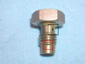

Most of the carbs had the fuel inlet hole to the pickup tube on the main jet drilled AFTER installation. Meaning, if you turn the nut on the bottom, it misalligns the holes and no fuel. Almost impossible to get back together. You need a service jet.
Service jets have a ring cut around the pickup area instead of threads, allowing fuel to go around an no holes to allign. That's the difference.

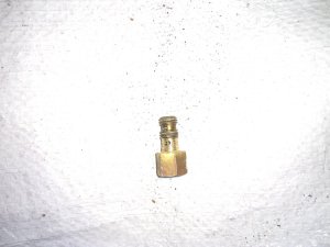

This is what you take out of the carb.

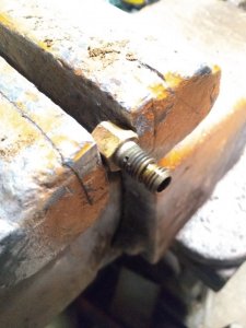

Note the threads

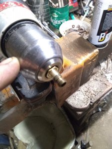

Chuck in drill, like so.

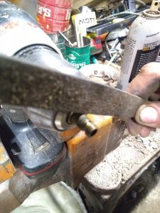

Run file in this area while drill is spinning.
Continue until you see no signs of threads. Then go just a little more.
TaDa! Service jet
Note the threads
TaDa! Service jet
