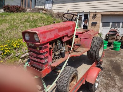

I picked up today what I am pretty sure is a MF16. The serial tag is missing.IMG_20250510_143929422_HDR.jpgIMG_20250510_143910577_HDR.jpgIMG_20250510_143859100_HDR.jpgThe engine is a 1974 16 HP Kohler and the grill on the right side doesn't have a hole for the exhaust which leads me to believe this is a 16. Anyone else know of any other differences between a MF 14 and 16? Or is there a place the serial number maybe stamped on the frame?

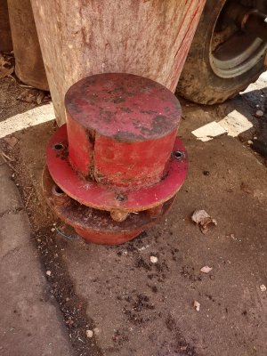

It runs :D. The carb I took a picture of I am not sure if it is any good. I couldn't get it to run with it. I pulled on of a 10hp I rebuilt and ran. I did have to replace the tank valve for gas to run to the carb. The wiring all need redone. The starter at first did not want to turn, I pulled it out and sprayed pb blaster on the bushing and it worked. I had to hotwire the coil, I was surprised it had spark. The best news is the hydro works fine. It just needs all the linkage freed up.

Snapper built these and the Massey models. Only difference between the 14 and 16 is the engine and decals. The Massey usually came with Sundstrand hydro, while Eaton (finned/round) hydro on the Snapper badged.badge. that's a 76 year with those extended footrests!
