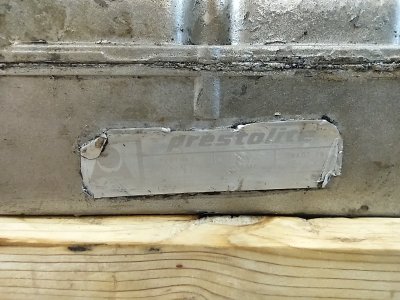

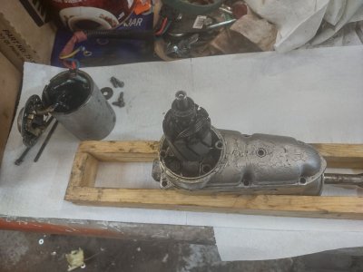

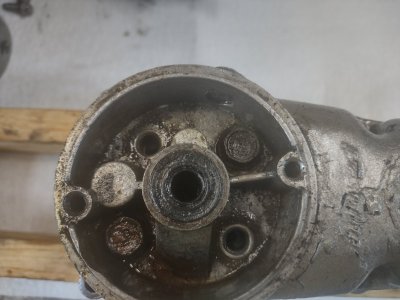

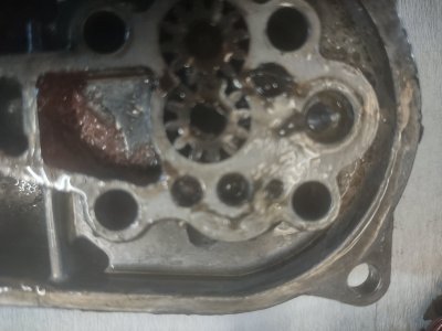

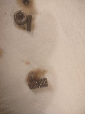

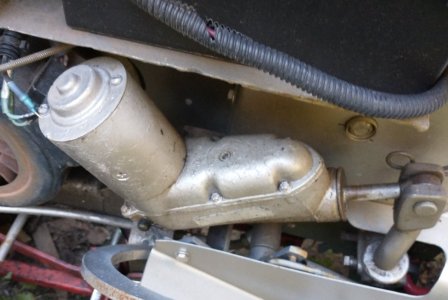

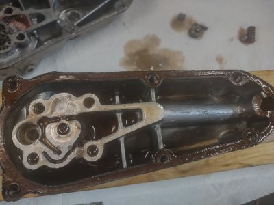

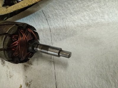

This power lift was on my MF 12 hydro when I bought the tractor. This is the first one I had seen, I have since seen one more on a MF12 at an auction. Here is a picture mounted on the tractor.IMG_20220725_200948275~2.jpgIt worked great until last winter. At that time I took the cap off the motor and resoldered a brush wire and it worked. A few months later I was using it and smoke came out of the motor. I took the motor off and took it apart. Here are some pictures;IMG_20241116_082633081_HDR.jpgHere is a picture of the prestolite tag.IMG_20241116_082654147.jpgThe end of the motor is machined with a flat spot to go into a oil pump gear.IMG_20241116_082736112_HDR.jpgThere are 6 screws around the edge of the housing and 4 bolts to hold it together.IMG_20241116_082804507_HDR.jpgHere is underneath the cover, oil pump and to the right of the pump is one of the check valves IMG_20241116_083055495_HDR.jpgIMG_20241116_083524022_HDR.jpgIMG_20241116_083510024.jpgThere are 2 small check balls also.

That little bugger is more complex than I would have thought.
There isn't a starter motor of sorts out there that might help with that part. Again only throwing spit balls here...
Could be SOL...
May have to reinvent the wheel here..or hope by chance you stumble across one.
Just for shits and giggles take a look around on Surplus Centers web site . Might give you some insight for your imagination.

The only motor i have seen close to the same size is one from a Kitchenaid mixer (long story for another time), the actual part i need is the field coil and brush holder.
