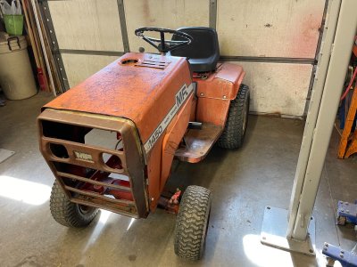

MF 1450

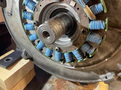

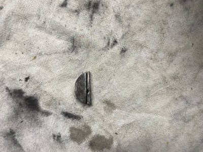

I should have explained that better, guys! That's why it turned over so nicely with the head off. I had to grab the electric clutch hub to stop the engine rotation, but with compression it would lock it up and let the flywheel spin on the crank.
By the way, Daniel, This flywheel is held on by a 3/8" fine bolt not a nut. Probably part of the problem! Your installation procedure would have helped I bet!

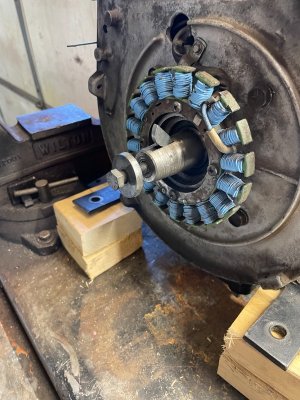

The starter still sounded like it had drag on it but must have been the friction between crank and flywheel. Obviously it was a lot of friction looking at the damage!

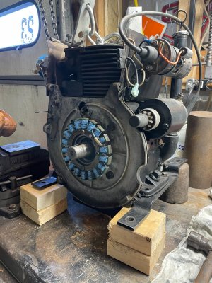

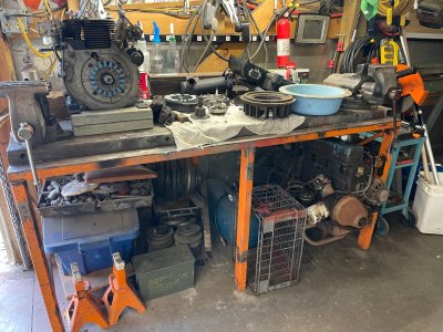

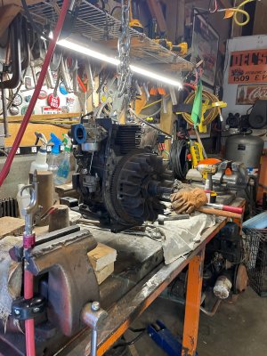

Was in town a good bit of the day but got home and moved the boat anchor to the welding table and shoved the tractor outside.
Had rolled the engine over to the table and figured that I'm still man enough to lift it up there and block it up. Nope not man enough anymore. I lifted it but it also felt like things were going to get hurt in my back worse than it already is! Sat it back down in a hurry.

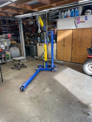

Got out the cherry picker and set it up with one leg down. Both legs wouldn't have fit under the table with all the heavy junk I have stashed under there. It was very stable thankfully!
After I got it in place, it dawned on me I couldn't put the flywheel on unless I used shorter blocking. Didn't have any so had to cut some.
That was pretty easy to swing the long blocks off one side, then put in the short ones.

Doug, Thanks for posting a picture of your workbench.
Makes me feel better about mine,
Rick, his bench is pristine compared to mine!!
That's not a workbench. It's my welding table! You don't want to see pics of workbenches!

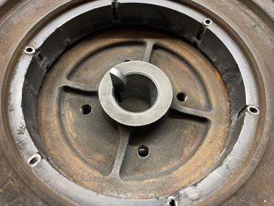

I think the "tooth" of the rough surface may help the Loctite grip a bit better. Will do like Chris suggested and file off high spots and get it clean with brake cleaner and compressed air.
The key ways in the flywheel and crank are surprisingly tight and square still. The key never hammered back and forth in the slot. Looks like it is a 3/16"x1" woodruff key. Tractor supply has some. I have to fill the propane tank in the motorhome tomorrow. Probably will dump the tanks out at the Truckstop near TS and swing in and grab a couple.

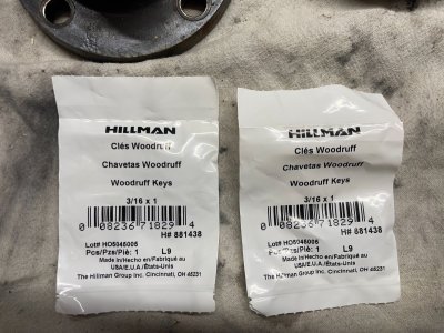

Got to Tractor Supply and picked up 3 woodruff keys. Just as well have a couple extras.
Seems to fit nice and tight.

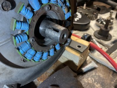

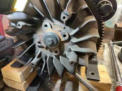

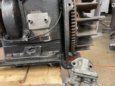

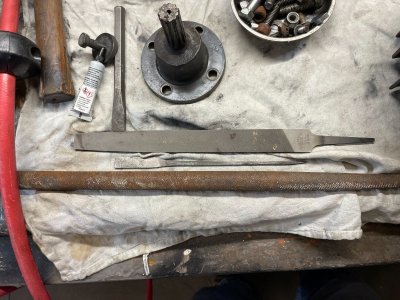

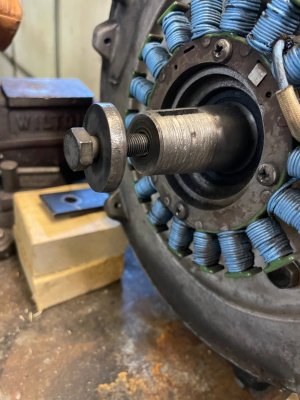

Got the flywheel installed this afternoon. Hopefully will assemble the rest tomorrow. I don't want to mess with it until the Loctite is cured. Of course, there is a very slight rub of the flywheel to the aluminum plate behind it. Hopefully it will "clearance itself". The starter isn't rubbing and should work fine.

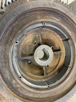

Knocked down the high spots with 3 different files.
Cleaned everything up with carb cleaner and blew things off.
The flywheel still needed shavings cleaned off the magnets, so I used some rare earth magnets to pick up them up. Figured the only way to get them off was a stronger magnet.
I had used the neon file in between the flat and round to deburr the keyways, then put in the key. Still a very tight fit there.
Didn't get any pics of smearing the 660 on the shaft and inside the flywheel but one tube was enough. Put blue Loctite on the bolt and used Daniel's method to tighten, and whack the flywheel. I used a 1-1/2" socket that cleared the washer. Specs said 27 ft. lbs but I went to 40. Tractor Supply only had course thread grade 8 bolts so this is still the same bolt.
I had already wiped off the excess in the above pic.

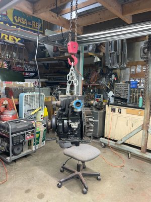

Made some progress today. Got the engine off the welding table with the cherry picker.
Then moved it where I could get the electric hoist hooked to it.

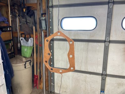

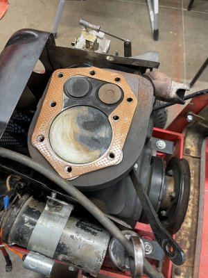

Got the cherry picker folded up and out of the way. Cleaned the old head gasket and sprayed it with copper coat.
Set the engine down on a steel milk crate and pulled the fuel pump to make a block off plate. Definitely want to do gravity feed if this thing will run again. Made sure I had a new gasket first. Put some black RTV on the gasket and put on the plate.

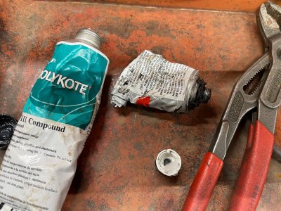

I'm sure you guys know this but if you use a little Vaseline in the cap of the RTV tube you don't have to dig set up silicone out to get to fresh stuff. Probably been a year since that tube had been opened the last time. I use this molykote grease since I have a tube of it but Vaseline works fine.

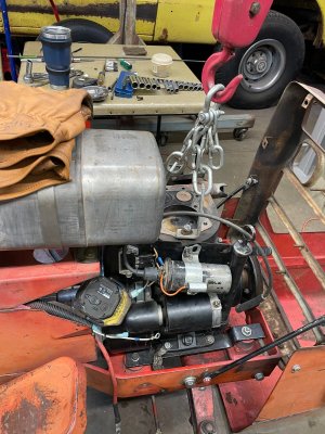

Put the blower housing and flywheel screen on and repaired a couple of bad wires. Then it was time to drop the engine back in the tractor. Rolled it in and added an engine.
Got the motor mounts pinned and hooked up the driveshaft. Gooped some of that molykote on the splines since I had it out. Was easier than getting out the grease gun---LOL!

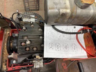

Took the lifting chains off and cleaned the block and head to torque it down.
Went over it 3 times, added 5lbs since I had to use an extension.
My back said that was enough so that was enough! Might try to fire it up tomorrow.

Thanks for the replies, guys! Your welcome on the Vaseline thing. That Molykote I used is basically an industrial grade of Vaseline. Parts man at my former job threw that almost full tube in the garbage and I took it back out.

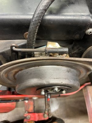

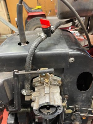

Re routed the fuel line for gravity flow and found that behind the throttle rod from the governor had plenty of room with the air filter housing in place.

Maybe the key is shearing again. Kind of acts like it did when it was happening. Think I got a bad tube of Loctite 660 also. Found the stick I used to apply it and it is not cured hard.
