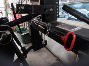

A few little things I did to make things a little more convenient for me.
I added a 18" magnetic strip (HF) to the back of the 3 point quick hitch to hold extra pins and such while hooking/ unhooking equipment.

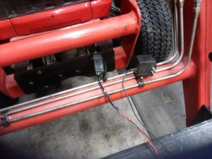

Also added a permanent remote plug for a trickle charger. It's just a trailer plug I wired in to the battery and also to the charger. My battery isn't the easiest to get at so this works a lot better and quicker.

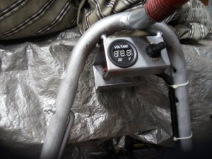

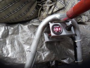

I added a volt gauge to my 5k generator to keep an eye on the battery voltage. It usually sits for months and months on end so at flip of a switch I can see how it's doing. Cheap little LED model and put a toogle switch for on/off. I do keep a battery minder on it but had them go bad with no idea until you want it..
