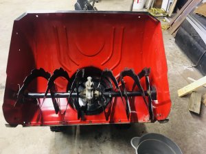

I sandblasted and epoxy primer the deck then applied automotive enamel. Its holding up well. Did the same with my snowblower. Rattle can paint is too soft to stand up to the beating mower decks take. IMO
I did both about 4 years ago
Definitely better finish than factory
BTW this blower deck done 6 hours work the past week. It’s well used70C843C0-E17E-47FE-8BF9-DCD77EAC13A3.jpeg
