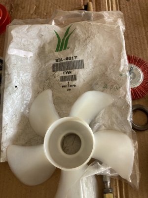

FYI... it is not advisable to run these small air cooled engines without having all of the engine tins in place... they are the cooling system and without them you run a very high risk of over heating the engine. Also... I dont see a fan on the front of the hydro unit.
