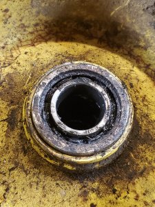

So the front wheels on my FF24 are from I believe a JD 400 or 425. I talked to the previous owner, he said he pulled them off a parts FF tractor so he wasn't sure. Well I need a wheel bearing and I'm trying to see if any of you recognize this one. It had a flat C clip around the outside and seems to have an outer flange, axle is 1". I do have a set of FF wheels, but they used just a bushing as the bearing, not an actual bearing.
Any advice would be great.
Get creative look at different uses,. Go on ebay and look up garage door bearings alot is 1" ID
Both my JD 316 & 112 have 1" spindles and use probably the same bearing. They just aren't as wide as the FF wheels. I have an extra FF wheel here and spare JD wheels. Maybe I can see if one of those bearings have a # today. If you pop it out and get the OD, may be able to take to a Bearing Supply and match those.
Did some searching in JD Parts. The 425 bearing is .984 ID so would not fit a 1" spindle.The 400 bearing is 1" ID and crosses with the 316 bearing. Part # AM102605 (AM33797) are probably what you are looking for. 1" ID/2" OD, 2-1/8" flange, 9/16" depth.

Like I posted above, pop one out and get the OD.
I had thought of that, but didn't want to pop it out and damage it and not being able to put it back on the tractor. I was hoping on of you had the info....and you came through.
Thanks
