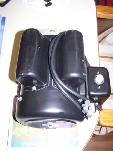

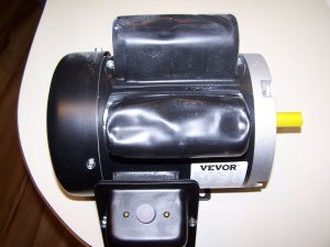

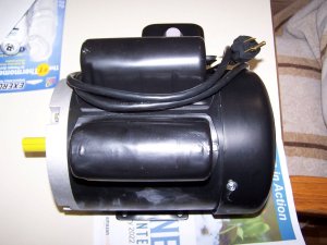

This is our beat up motor that FedEx delivered. We pulled the capacitor covers and found no damage to them. I used a large socket to work the dents out of the covers and got them installed. Dad wired it for the correct rotation and plugged it in. It sounds good so we mounted it up on the old $25 Table saw. It is replacing a 1.0 hp 1725 rpm motor. The new motor is 1.5 hp 3450 rpm. The saw cuts a lot better now.

We are in contact with them and they wanted to know if the motor still worked. We are working on a settlement of some sort. After all we paid for an undamaged motor so they should do something for us. Now we have repair time into it and should be compensated. We were/are hoping to get another motor or at least some new capacitor covers. It would be nice to get a new motor and be able to keep this one also because we have a jointer that needs a motor if we can repair a casting for it.

Just to be sure I went out and checked our 10" Radial Arm Saw. It has a 3450 motor with the blade mounted directly on the motor. Our table saw has the same size pulley on both motor and mandrel so no RPM change. I also checked max speed ratings on new blades and found they range between 6000/7000 so I should be good to go. Never hurts to double check.
