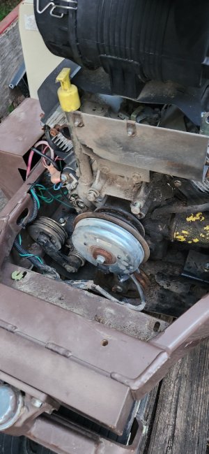

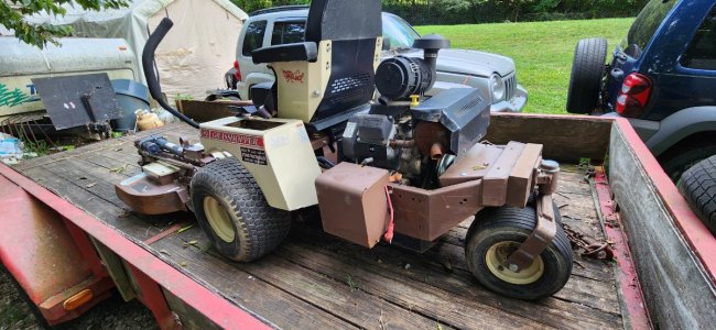

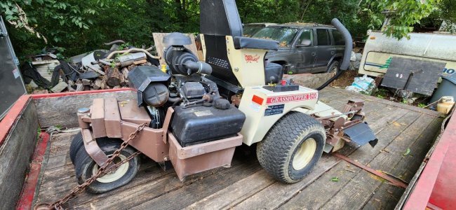

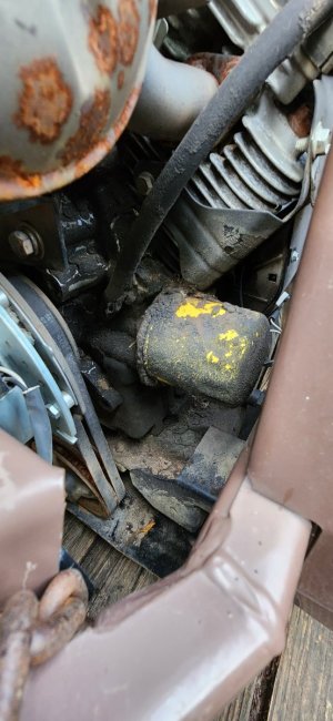

Picked this up from a buddy who works at local tractor/mower dealer/repair shop. He said a customer had them pick this mower up about 2 yrs ago because it stopped running while mowing. They determined it broke a rod, customer decided to buy a new one so they pushes this behind the shop. I got it for $250. I have determined 1 rod is broke and has a cracked hydro line, the oil filter is caked with stuff and was loose, I think they had leak and ran it low on oil.

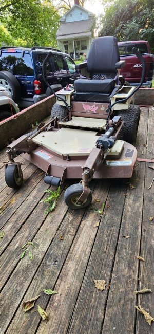

It is a GH 620T with a 48" deck, also has an electric lift/level attachment on the deck.
I started removing parts last night to get ready to pull motor.
