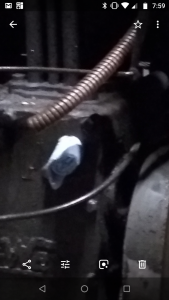

Also, heater exhaust hose that goes from the exhaust manifold to the inlet heater box manifold... mines not usable. Any replacement suggestions I should be watching for?
Would a piece of flex LP/Natural gas line work? Like used for gas cooking stock hook ups?

I would check it for spark, make sure it has oil in it, shoot a little oil down the cylinders, a shot of brake clean and see if it fires. It most likely has an oil pump that should be checked and oil changed before it's run too much. Also things like making sure the throttle moves and the linkages. That flex pipe is available depending on the diameter. Think the stuff they use for the Maytag exhaust hoses. The engine should run on gas without it. The heater was mainly for running kerosene.
They used to make (maybe still do) corrugated copper tubing. Or you could use Soft copper tubing.
Air-Conditioning-Bellows-Stainless-Steel-304-Inlet-hose-Explosion-proof-pipe-Copper-Fittings-DN20-25-20mm25mm.jpg_220x220.jpg
That may work. The stuff we use at work is SS ribbed with flare ends. I may be able to cut the flare off and rig it in

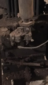

Sounds good, keep plugging away you'll have it running in no time, what does the carburetor look like on this engine?
Best pic I have. Inlet is square. I think I remember reading it was a Carter?
