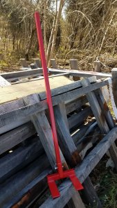

So there called. I have an unlimited source of pallets. They have three main runners of oak that are 8' or 10' long. They are 2 1/4 x 3 1/4. Each pallet also has several double oak boards across that are 1 1/4 x 2 1/4 x 48". I broke several down using a crow bar, flat bar & hammer but it wooped me good. I seen these for sale for around $40-$50. I made mine out of what I had & it works fantastic.
