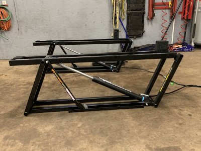

New to me toy, didn’t want a two post hoist in the way when I wasn’t using it and the two feet is ample for undercoating, tire oil changes etc

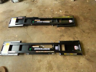

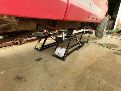

We picked up a quickjack BL-7000-SLX a little over a year ago. Only used it a couple times so far but it works great. Did the front brakes on my ranger. Next will be a clutch replacement. Would love a 2-post or 4-post lift but that isn't in the budget and don't have the room at this point.

I shoved on my truck pretty hard, and it was quite stable. You want to be sure you're on a clean, flat surface. Some people use jack stands in conjunction with the lift for added safety.

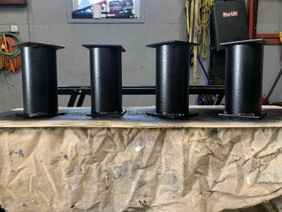

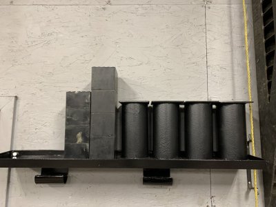

Made up 7 1/2 fixed adapters. Figured I’d spray them with a couple of good coats of rocker guard. It’ll make them more slip resistant probably add rubber pads to the top. I think I’m going to put conveyor belt in the four pockets on the top of the jacks. It’s very grippy when it’s dry, that way each different type of block will sit on top of it.

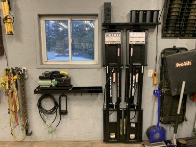

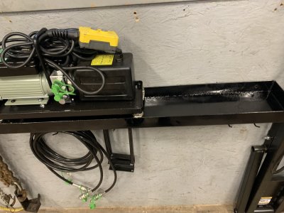

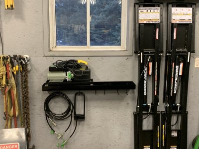

Made up a wall hanger for the jacks and the cross member (left space to the right for now) with a top shelf for adapters. I going to make a smaller one under the window to the left and put the hydraulic unit on top and the hoses under it.

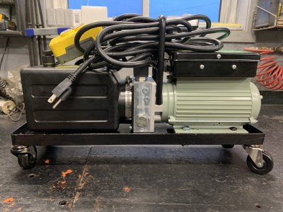

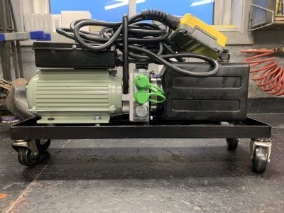

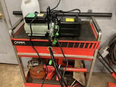

I made a little frame and added 2” casters to the hydraulic unit so it can be easily moved around the floor when in use. I’m making a 40” shelf below the window in the previous pic to hold it when not in use and the hoses as well.

Got the shelf thrown up just have to add piece of rubber belt to the inside. Gives me some extra hooks for hoses etc. and I’ll probably move the adaptors down onto it. Just took a piece of steel from an oil tank side and cut out the corners, bent it up and welded corners.
