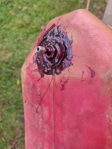

I went ahead and fixed the tank since it might be awhile before I find a metal replacement (if ever). It came out just fine, and at 6" of head pressure I don't think that the 1/4 PSI is going to overwhelm my connection anytime soon.
Not the prettiest thing in the world, but it should work just fine.
Conveniently, the fitting ended up below the vent hole which was just large enough for me to get my 3/8" extension through. It would have been more convenient if the hole had been below the filler hole I suppose.
I dropped my deep 12mm in through the filler hole and lined it up with the extension (easier than I imagined it would be to do) and I was able tighten the fitting down nicely from both sides.
The tank is a "Blitz" Model #11805 1 gallon, 4 ounce gas tank. The bulkhead connector is a:
"DERPIPE Stainless Steel 1/4" Hose Barb, Barbed Thru-Bulk Head , Hex Bulkhead Straight Fitting"
with the non-threaded end cut off. Gaskets were cut out from thin gasoline resistant gasket material and each layer of the gaskets and flat washers were coated with Permetex.
Bulkhead fitting: https://www.amazon.com/gp/product/B08DXJH7KK/ref=ppx_yo_dt_b_asin_title_o00_s00?ie=UTF8&psc=1

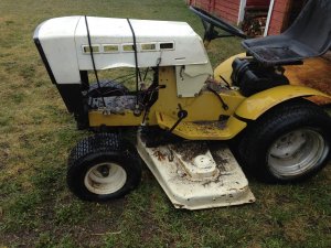

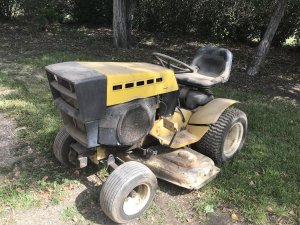

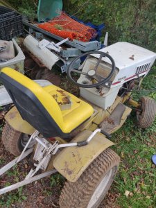

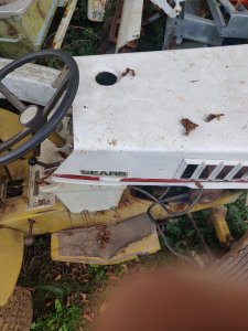

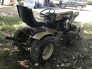

The tank and a couple of shots of the tractor.
