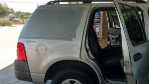

My Daughter's 2004 Ford Explorer took a baseball shot to the passengers side rear quarter glass with a baseball the other day and I'm going to replace it myself. I found the correct tinted glass at my local auto recycler for $80.00 and found a paint and body supply house that sells the urethane sealer to install the glass with for $22.00 + tax. This window is a fixed glass and is installed like the newer windshields with only the urethane adhesive mounting it to the body. I've got the shattered window taped up with duct tape to keep it all together, I hope! Mobile glass wanted $275.00 for a new glass and install, $100.00 to install a used glass so I'm going to do it myself.
Has anyone had any experience doing these glue in glass replacement jobs before? Any tricks I might need to know?
Thanks and photos to follow.
