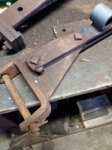

I should have taken before pictures but I didn't. I was too busy beating banging and cussing. After a little cussing. Judicious use of a BFH, heating with a torch, and using a 1/2" impact at 120 psi, and just a little more cursing It all came apart. The plow share is well worn and has a chunk out of it, and the moldboard is missing except for a small triangular piece.

I removed the vertical support from the landslide assembly. I may try to attach a plowshare/moldboard assembly to this landslide and reattach the vertical support and reassemble the plow. I may have an extra sears plow that could donate its entire moldboard/land slide/ plowshare assembly after removing its vertical support. I will have to wait until Wednesday evening to know if I will have the Sears plow. A gentleman is buying all my sears stuff in a package deal and I'll "buy back" one of the plows if he is okay with that. Otherwise, I will sell him exactly what we dicussed.
