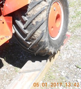

Since I only have 10" &12" plows, I started by making a set up to get the tractor like it was in a furrow. With a 10" plow, you need the LH wheels up 5". Here's what I made. It's 2 4"X6" (3.5" X 5.5") blocks with a 4'+ 2"X6" screwed on top to make it 5" tall for a 10" plow.

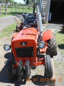

And here is Alice 'assuming the position'.

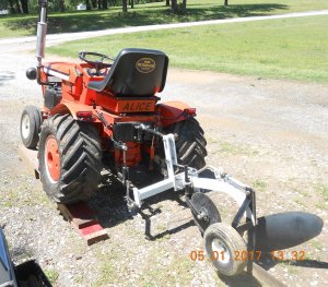

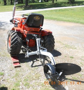

I hooked up the 10" 3-point plow (converted sleeve hitch). I adjusted everything so the plow was setting flat on the ground. This gives you a basic setting that may need tweaked when you plow.
With the 3-point, you adjust the top link for getting it nearly flat forward to aft, slightly up in the rear (1/4"). Lift links on the arms adjust for side-to-side flatness. If you have a sleeve hitch plow, the only adjustment is the crank on the plow for forward to aft.
I then backed Alice off the boards and added a 1" piece for setting the 12" plow. Nothing changed from my initial settings. But ground conditions may vary and tweaking may be needed.
