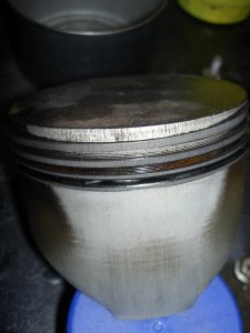

Looks a little like the piston I pulled out of the JD 200.
