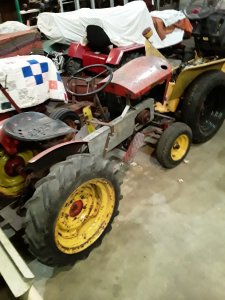

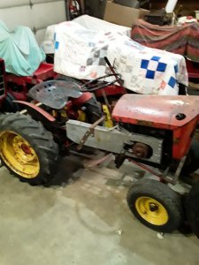

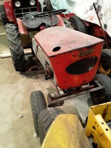

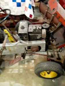

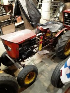

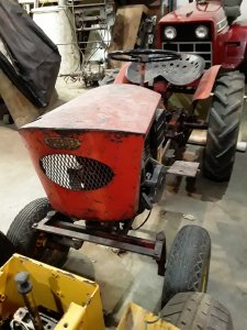

Brought home another project today.
1966 Speed-ex S-18 Briggs engine.
Something else to do this winter.

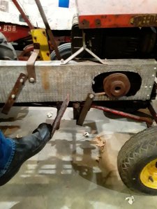

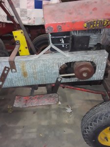

This unit tightens the drive belt by sliding the engine.
First picture is with the clutch/brake applied. Second picture is with full pressure on drive belt.
Note position of foot pedal and engine pulleys in belt guard.
