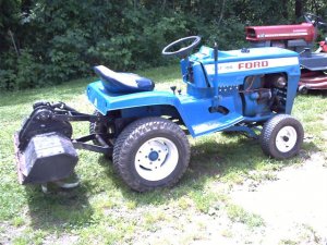

My tiller tractor is 10hp Kohler. Works fine. It rarely bogs down, only if dirt is quite wet.
