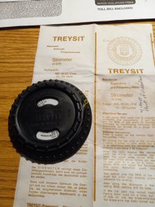

I had to go find mine. The instructions were with it. The instructions are kinda vague, and don't differentiate between 2 or 4 cycle. It just says that it reads the crankshaft rpm. I wrote a note on mine to read it at the widest point of vibration. good thing cause I had not used it in a long time and had forgotten.
