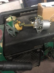

I tried to buy walbro on ebay..bought a carb that was supposed to fit my Coleman Pulse 1000 generator but the mounting holes were too close together even though the vendors state they are exact match...sent vendor pictures,,they refunded my money as they had none correct in inventory.B534C829-D3AC-421A-A03E-644EE3298E7F.jpeg
Jazz.... that looks bigger than what I'm talking about, which would be teh small "ice cube sized" carbs used on chain saws, weedeaters, leaf blowers and such.
