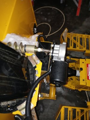

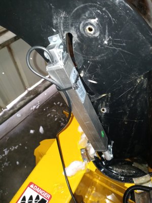

Brought the Walker into the 21st century with an electric chute rotator drive and linear actuator for the deflector. Tried an 8.8lb actuator and as soon I hit deep snow it tore in half. I ordered a 55 lb one and it works great. No more hand crank or having to get off the seat to adjust the deflector.
