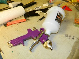

These HF HVLP guns are on sale for $9.99 almost all the time. I've not used mine but I have a friend that is a restorer of old farm equipment as well as cars. He says these things spray great and they are so cheap he doesn't even take the time to clean them He throws them in the trash when done! Sorry, I will clean mine after use and keep it around for awhile!
