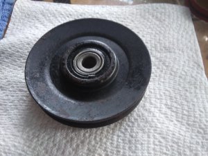

This is an MTD add on part, 3/8" bore X 3" diameter A belt or the old fan belt idler pulley. Closes I could find was from Northern Tool, 3/8" X 2-5/8 V belt pulley. Took them 2 weeks to figure out they were out of stock and on back order. This idler provides tension on the fan only on a d600 Kubota diesel in a 1512 C C tractor. Everything I found is 5/8 bore X 3" V belt application. Possibly make a V belt pulley work, belt would ride deeper in the pulley but have plenty of adjustment. Anyone have any idea on where to look to find one would be appreciated.
chieffan

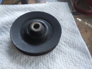

Not sure if it is a single bearing or double bearing. It is crimped in on both sides, lot like the electric PTO clutch bearings are. Another bushing goes on with the bushing built into the pulley but not concerned about that as I have bushings. 20210608_094804.jpg 20210608_094818.jpg It turns again now but rough and noisey. It was seized sold when I took it off.

With crimped in brgs I've carefully ground the crimp off with a carbide bit in my die grinder, knock the old brgs out and use a liberal coating of locktite on the new brgs and bores. Haven't had one come loose yet. The one in the left pic looks like it may be uncommon so can't guarantee availability.

If you press that bushing out of the center, you'll probably find a 5/8" bore for the bearing.

No pressing it out. Crimped in good from both sides. I have seen those Phonex pulleys but they do not state the belt size and no wide at the belt contact point. Only over all width which don't mean much. Might make a 1/2 wide pulley work but no a B belt pulley. That is where I get hung up on all the listings. Waiting for a reply on a couple now. Last one said "We have over 16000 items in our ware house and do not have that information." By-by baby !

Missed that post some how, sorry. I tried that with a PTO clutch bearing. Same bearing number but the replacemend was a tiny bit samaller and fell in and out. Might have to go that route, then try and find the right size bearing. Have a good source in Omaha with Baum Iron. If they cant get it, probably isn't made.
