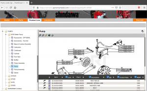

I have an shindaiwa shaft drive trimmer (T254), and it is echo's commercial line with a few extra bells and whistles. This trimmer is bullet proof, very little vibration, quiet, fuel efficient, can't say enough good things about them. These motors are also made for the commercial user to maintain them easily supplying all diagrams and part numbers from shindaiwa's web page under tech support- to parts lookup, find pump. It's too easy.
As an example,
I hope this helps
