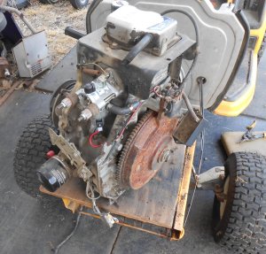

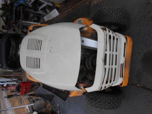

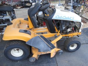

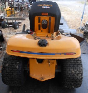

Brought this home yesterday! Owner got it a bit warm shall we say. Very nice looking machine for a late 90's model!

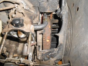

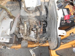

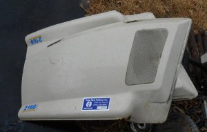

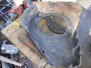

Here's the carnage:

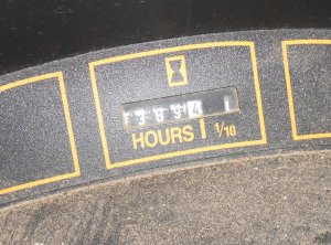

Only has 389 hrs on it:

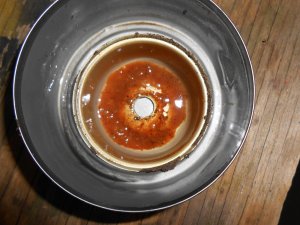

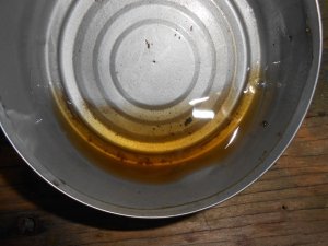

Pulled the solenoid and carb bowl. As I suspected, the solenoid was toast and full of crap. Along with the carb bowl having crap in it.

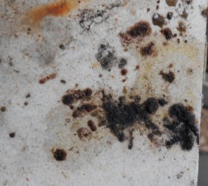

Caught this as I cranked the engine over:
This was in the solenoid:
Snipped the end off the solenoid and cleaned the bowl out. Took a bit to get the carb filled back up, but it ran on it's own.
That’s weird a lot of those shaft drive Cubs almost free around here. You can also see them sitting as scrap in yards or fields. I’ve been curious about why so many of these have so many problems. They look like they are built well.
Not sure I'm following Kenny.
Melted cause the engine got hot or caught fire.?
Sure looks like a fire....
HI Kenny I understand the heat part but what was the cause of the heat was it like the Russian ship did a cigarette get dropped into the bowls :p
The owner caught it on fire using ether to try to start it.

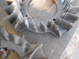

Good score, Kenny, but dang it really melted some stuff! Never seen a plastic blower housing before. Didn't hurt any plastic fins on the flywheel?

I think a couple fins are melted. Got a new one coming anyways. Sure throwed a bunch of crud out of there when it fired off.
