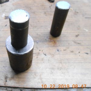

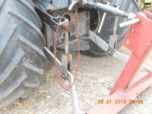

I was needing another set of the parts circled in the first pic to complete the 3-point on my other Sears FF20.

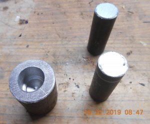

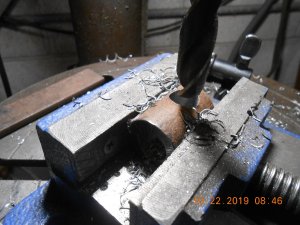

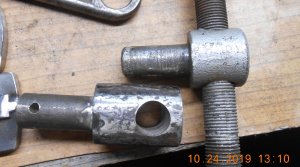

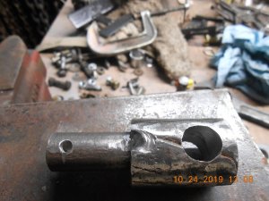

The fabricated parts will be used on Alice as I made the lower lift arms from 5/8" thick material and the 'stock' links are just wide enough, making a tight fit there. Here's a few pics of what I have so far. I located some 1.125" diameter rod and cut 2 pieces 1.5" long ('stock' parts are 1" long here, hoping for just a bit more lift height). I have them drilled to 9/16" right now, waiting for the 37/64" drill bit to arrive as these holes will be threaded to 5/8-18. Then I drilled the long ends to 5/8" for the pins.
More to come today on this.

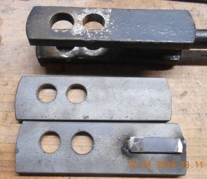

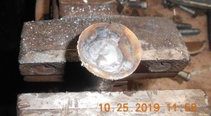

Here's the new pics. Not nearly what I had before as I am beyond that point. To weld the pin in the top piece, I drilled three 1/4" holes around the perimeter to weld them in with.

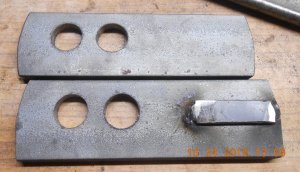

Next I cut 4 pieces of 1/4" X 1-1/2'' X 5" long strap for the bottom section. I offset the holes I drilled as the original was only 1-1/4" wide.
I found material to set the spacing.

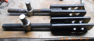

Here's what the new looks like next to the original.

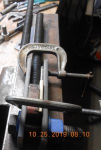

A spacer is needed for the 5/8" bar to weld in.

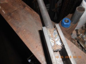

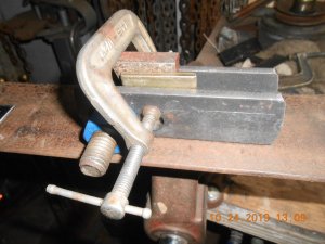

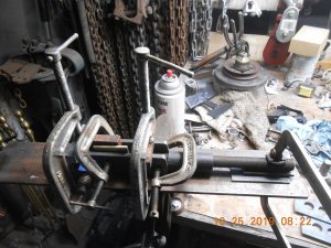

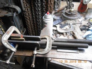

Since I got the drill bit and threaded rod late yesterday, I got after things this morning. First I cut the rod into 8" lengths. This was what was needed. Had to grind a small part of the threads so they fit snugly. I got things situated as I wanted and tacked the rod in 4 places each side before welding solid.
This is the wire I'm burning:
Got a nice coffee warmer

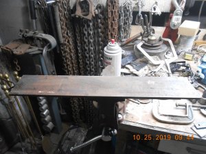

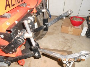

Here's the links all welded together.

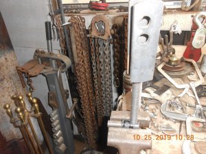

Here's my small welding table. A piece of 3X3 angle in the vise.

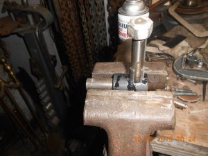

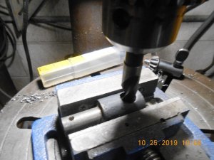

Next up was taking the holes out in the adjusters for the 5/8-18 threads.
Tapped those out. Things fit just fine.

Looking good Kenny. I cheated when we built my lift links, Used 2 nuts on the top end on the threaded rod. Old wrench stays on that tractor to break a nut loose to adjust. Issue with that is hand tightening won't hold when using a blade on a drive, etc. Nut will loosen and change the setting.
No way these will do that!
