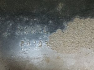

may be bringing this home early next week, cant find any info on it.... I took the numbers down from it, but left them in the truck..... model number was 20XXXX and code number tells me it was built in 1972. I can't find anything on any Briggs with a model number starting with "20". Definitely Briggs, looks ALOT like a 320000 series 16hp but obviously slightly smaller.
dodge trucker
ok went out to truck, got my cardboard scrap with the numbers wrote on it... 200401 0190-01 7208151 it's on a Binks air compressor, looks way overbuilt, about 15 gallon tank, compressor unit almost as huge as the engine, think its a single stage hope I copied them right, not been run in years but don't think it ever spent a night outside.

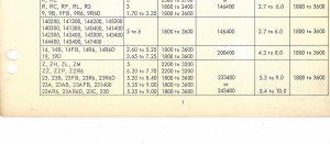

huh according to that list that Kenny showed, a 201400 is a single cyl Vanguard OHV... this is definitely cast iron L head. Vanguards were not even thought of yet in 1972..... I'm guessing it's either a 9 series or a 14 series..... flojet carb, looks like magna matic point cover....

ok been a while... this contraption is now in my garage... engine numbers... 200401 0190-01 7208151
unloaded it from the bed of my truck and wrapped the rope around the pulley, gave it a shot of starting fluid and pulled the rope, no fire.... have to check the points. Its definitely a cast iron Briggs/Magnamatic points ignition. part of engine decal still there, bottom half of number missing, the "HP" part of decal is still there, I'm thinking it's a 9. Could be an "8" but I don't think they made an 8hp cast iron.

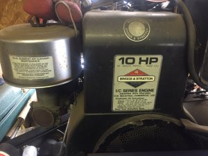

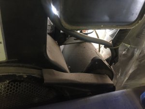

Just for entertainment sake, this is what I have on my bench with stuff piled on and around it. Had to move a few things to get the pictures. Hehe.

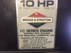

It has a starter/generator. But you can take the belt off and put a rope on to start it too. Check out the oils it can use.
