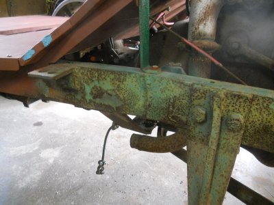

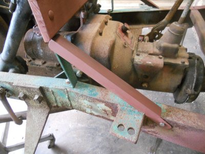

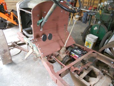

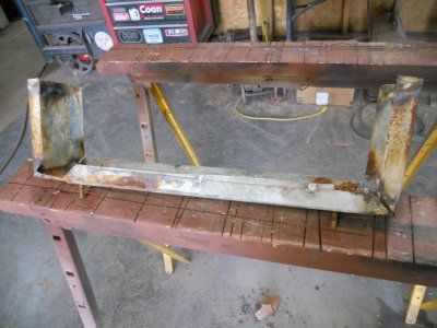

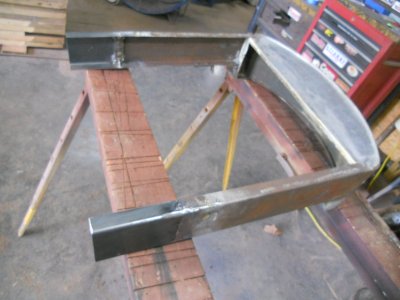

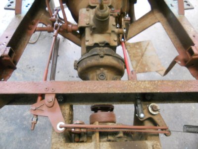

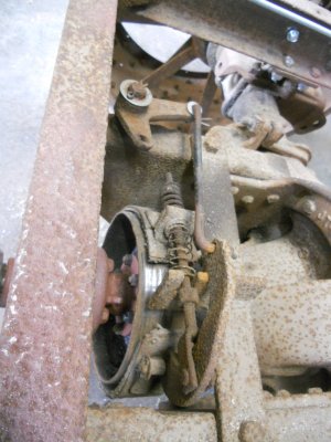

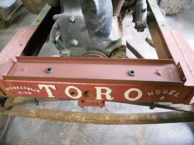

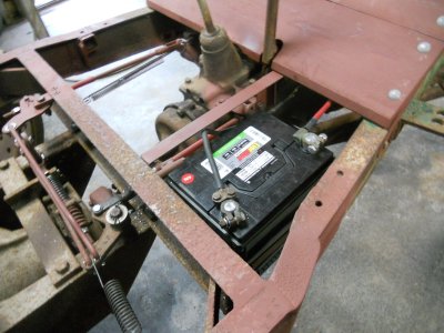

The frame splice is finished on the other side and here is how they look from the back.

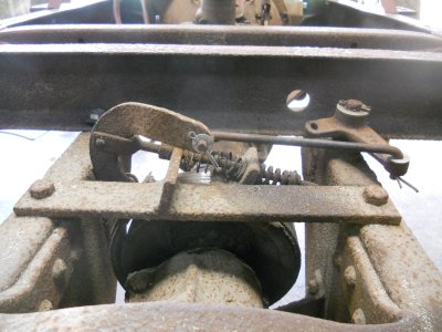

The back of the frame ends at the rear axle.
I took about 10 inches of the two pieces of frame that I had cut out of the center and added them to the back of the frame to extend it out to about even with the back of the rear wheels.
Pushed it outside to get a couple of photos.
The weather is going to start getting colder tomorrow so that will stop the work in the garage for awhile.
Fantastic work. You have a great eye for balance and appearances too. Your frame adjustments will look far better than the original Toro design. I really like it.
