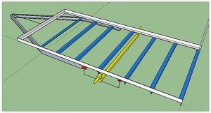

I am getting a set of springs and a dropped axle soon. The axle is 1.75" square solid (not tube) with a 3.5" drop, 5X4.5 bolt pattern. (Second axle from a travel trailer). Springs are 5 leaf, probably 3500 lb. I can only go 5' wide, so going with 10' long. Here's my drawing:

If I were widening that axle, I'd try to find a solid piece of the same size, weld it in, then use 2 1/2 x 1/2 plate on front and back, a foot past each butt weld, welding it in along the length only....no vertical welds.

That 1.75 square solid would be real hard to find for me. I really wanted a 6X12, but this will have to do.

Sounds like a good project. I would hold off until you found a way to widen the axle. That's a nice build plan to settle for just 5' wide.

I'm assuming a vertical weld would weaken the axle at that point ??
