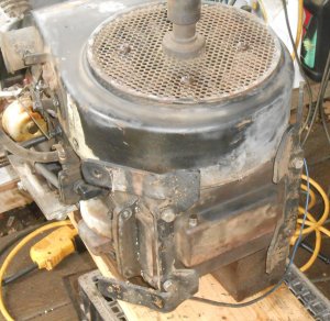

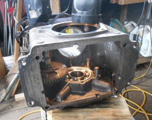

Edit: This post on the other site posted by Brian shows some pictures of different blocks and his observations on oil pans.
I put a wide base K341 out of an AC 416 in my closed side Ford. The smaller (Ford) pan fit fine as the ears on the block were not open.
On the AC engine, the holes were already threaded for the Ford pan to fit!
From what I remember, thats what I need to fit in the ford. I know it has those brackets for the rubber mounts, and the block and pan pictures look like what I have in there now on the 12 hp k301. Thanks Kenny.
Noel see two farthest out holes on each side of the block ? That's the "ears" I'm talking about that mounts the big pan. Not all blocks have those.

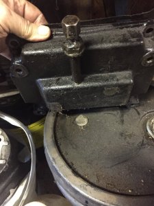

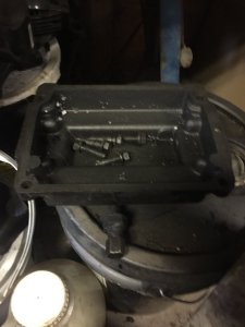

This is the base from the 14 hp k321 that was in the tractor once upon a time. So then the mounts go on the engine for the rubber mounts.
Would this base be the same as a 16 hp k 341. ?
