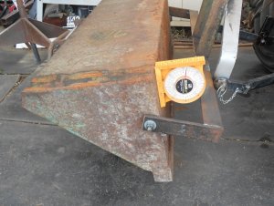

"Got to limit the dump function"
Not seeing where that's really necessary Kenny. ?
Sure there's a reason for it though.
Coming along nice. !
It goes too far on the dump. Gonna be hard to get it latched back as it goes now. Would have to stop and get off to bring it back to be able to latch when the lift is lowered. Would like to see the 'bottom' of the bucket only go 90 degrees not 160.To me it looks to automatically limit dump angle??
Oh, now I see! Had to look closer to see the bottom of the bucket faces towards the driver's head!It goes too far on the dump. Would like to see the 'bottom' of the bucket only go 90 degrees not 160.
That would mean totally starting from scratch as the latch mechanism is designed around the pivot.What if your pivot point was up higher Kenny. And maybe back a little.
That's what I'm thinking, Daniel.Kenny, you could put appropriate length of 1/4" chain from top of bucket down to the stationary frame on one side or both sides to limit the tilt.
Makes it hard to use the quick attach feature. Just drill a couple of holes in the bottom of the bucket. Even a 3/4" hole won't be a bother 99.5% of the time.Some people just don't figure out it is best to turn it up side down
That's a good way for yours, but I think my bucket is deeper and I may not have as much lift. Thanks.My dump bucket is similar and it only pivots about 100* back. My pivot is right at the back though so maybe you can try adjusting that?
