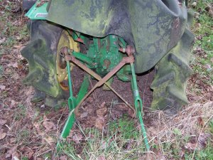

Went and looked at this Yanmar YM1510 D today. They said they can't get it to run, but it does turn over. It also has a broken upper lift arm on the 3 pt and possibly something wrong with the front drive system. We will know more if and when we bring it home.

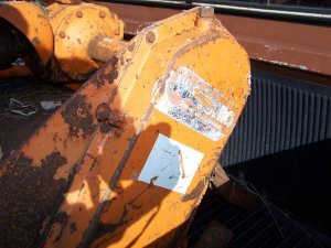

We got the tractor loaded and hauled home today. They threw in a rototiller that went with the tractor also. Now its time to see if we can get it running and check the front end.

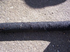

After running it a bit we found the charging system and hydraulics aren't working. I think the VR is bad because the alternator is putting out 33 volts AC. I checked the fluid level for the trans/hydraulic and it is good. Pulled the filter and it looks plugged. The new filter should be here tomorrow. Also has a bad looking hose going to the pump.
