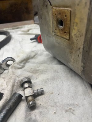

Pulled the fuel tank and checked the shutoff valve for screens or blockage. No screen and it seems to open correctly.

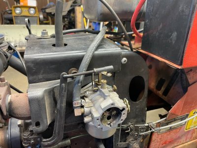

Decided to re-plumb the whole fuel line eliminating the chinese shutoff valve. Since the fuel line was disconnected, the carb got removed (pain in the @$$) and checked over. Chinese carb too, this thing had no carb on it when I got it.

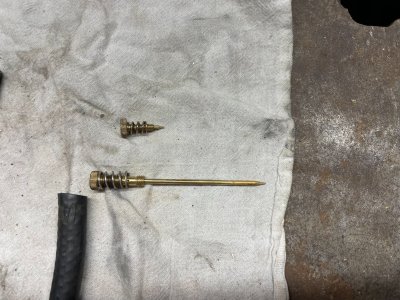

Took the idle and high speed needles out and they look to be in good condition.

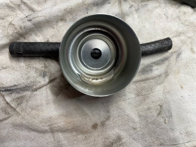

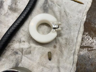

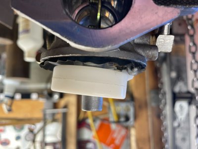

Float level was real high so like a genius I decided to level it like normal carbs. Pic is upside down to show closed needle position.

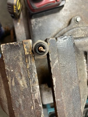

Spark plug color looks pretty good to me.

I can get it to rev now kinda, but it is running super rich. How did that happen? When it blubbers and dies, black smoke blows out the carb and even liquid gas. Don't idle as good as before either. Wish I could afford a new engine---LOL!
I guess I better put the float level back even though it seems backward to me. Then start going through the ignition.
Float should cut off fuel with float level to carb. The adjustable jet needle for high speed is center top. The jet on angle on side of carb is low speed adjustment.
I must have really worded things badly in that last post Daniel. That high float level picture I posted was from the factory. I had never taken the bowl off until yesterday. I didn't take a picture of the float level after I adjusted it. I also know which screw is which. I set them to factory recommended settings before starting the tractor yesterday and tried adjusting from there. Couldn't really get the engine to run well enough high speed or idle to do good adjustments.
