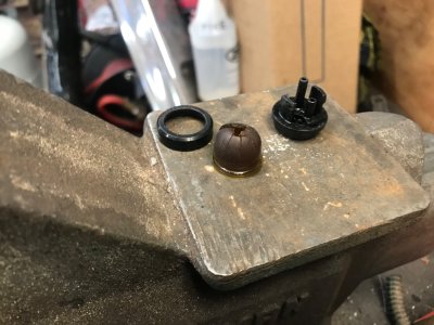

Not tooo much done on the whacker as of late but I do still have it. Finally after putting the correct gas and oil mixture in the tank, I had my stepdad try and start it for me since he is stronger than I am and it ran at a high whine for about 30 seconds. I let it sit for a few weeks then I dug it out again at the end of March 2 weeks before my kidney transplant surgery, and I took off the primer bulb because it was brown and cracked so I figured maybe thats my problem. That said I will have to order one, put it in, put some seafoam in the tank again, fill the tank some more with my gas and oil mixture, and see what happens after that. If anyone else has any other ideas, I am all ears.

Maybe you can bypass the primer bulb and try starting it, before you buy another one. Just hook the two hoses together, or if one of them is long enough, hook it directly from the carb to the tank. You may need a squirt of fuel in the carb to get it to start. If it runs right, then you know that was the problem. If it’s not any better, then it’s probably something else.

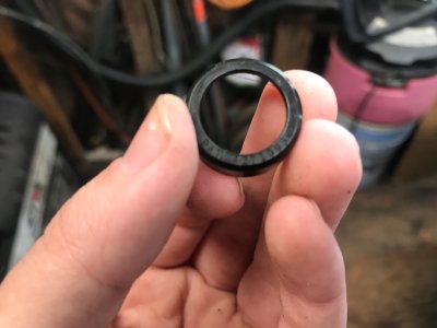

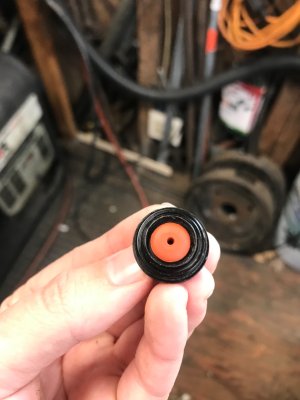

Hi Everyone,
