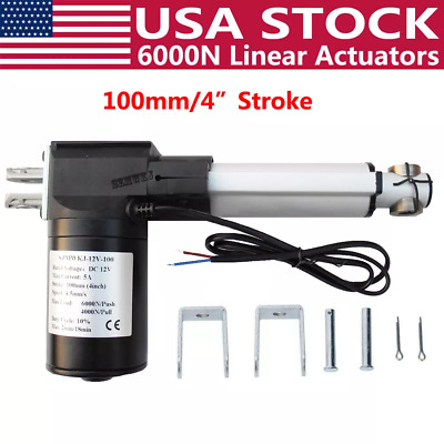

The snowblower on the B2601 came with hydraulic lift and hydraulic chute rotation but has a manual deflector on the chute, in the past I have not changed the deflector all the much but the Agri-fabs on the Husqvarna had a cable lever assy that could be used from the tractor seat, so I decided to install an electric linear actuator to operate the deflector. So I ordered a actuator from EBay it came with 2 end clevis pins has a 4" range and its fairly slow which is ok for this use and the spec says it has lots of push/pull power, although not a real big deal in the use. Today I worked out how to mount the actuator to the chute and started on wiring the switch and the wire cable to go from the blower to in the tractor cab. Got a good start on it today

When you say the actuator works a little slow...how slow ?
Just for future reference on my part..

4.5 MM / sec its not really slow for this appication I wouldn't want it so fast that you are overrunning and hunting for the position wanted
The IP54 rating is very low. You may want to consider adding a cover boot for protection. IP64 or higher is best.
Guess Brett has a point there. I never knew or even considered the IP rating other than a sales description whether or not its moisture proof .
But have heard of guys installing the actuators upside down to keep water from seeping in for that very reason.
