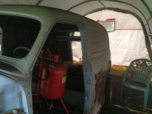

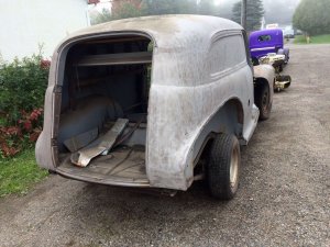

1 bag is plenty. Hang a tarp as back drop and place parts/ tractor on tarp on ground so you can recover media for reuse. SIFT your sand to avoid clogging. I sift new sand out of the bag as well. Clogging is too aggravating. A portable shelter is great for sandblasting but not necessary. Just makes recovery of media easier. I used 6 bags to completely sandblast this car inside/outside and underneath

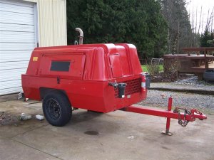

I have been using my old Curtiss 5hp shop compressor for several years. I don't know what CFM it is, but it produces enough air for my blast cabinet. My pressure pot will run it to death if I don't take breaks often enough. We had an old trailer model compressor that I used for years that was rated at 125 CFM @ 100 PSI. It worked nice, but sometimes it didn't want to build pressure when it was in run mode. The last time, after it sat for a while, it refuses to build pressure. We have tried to find info on the machine or someone who knows old compressor's with out much luck. So it just sits for now waiting to be worked on.
With that compressor down I've been watching CL for the last year or two for a newer replacement. Well last week one came up for sale at a good price. We looked at it and decided to bring it home. Its was advertised as a MultiQuip 130, but when we looked at the title it was the 185 model. The PO used it in his landscape business for blowing out sprinkler systems and had it turned down to 70 psi. We turned it up to 100 PSI for now and will see how that works. It has a max of 125 PSI.
