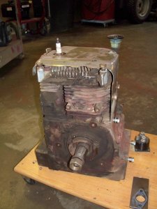

I've still got the parted out HH120 that came out of my MF12G and the head is still on it. I've been threatening to scrap it for a few years now, but thought someone might need something still. I'll take it off and send it, just pay shipping.

You're welcome Aaron, I'm glad the poor old engine was able to be a donor. I would have loved to keep my 12G original, but since overbore pistons seem to be made of unobtainium a repower was my only choice.
If @Tcoover or you want the head please let me know. Obviously Tcoover would be first in line.
