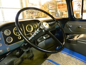

Possibly paint would work. 5 years ago I painted the steering wheel on my '55 GMC. Picture is today. It still looks pretty good and I've never noticed any black on my hands. It hasn't worn through anywhere. The paint is ordinary Krylon satin black spray bomb
