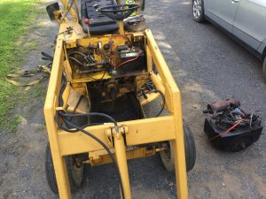

I got the electrical wrapped up, and the hood back on. When I was at the hardware store I forgot to get a pipe for the oil drain, that will have to wait Until tomorrow. Once I can get oil in the engine I can do the spark and smoke test on the electrical, as well as see if I have the throttle hooked up right, I am not too sure on it.
Here is a picture from the other day, you can see the coupler. The coupler is a double U-joint that goes over the output and input shafts about 1” on each side.
When I put the engine in I did not check how far in the shaft was to the coupler. I slid the engine back as far as I could until the air filter barely touched the battery tray and marked the holes.
When I put the engine back in after drilling holes I noticed the coupler did not go on very far, about 1/2” at most. I was able to cheat the coupler forward a bit, as the pump input shaft extended through the coupler, and than some. I now have 3/4” or so on each side, and i was confident at the time, but I am starting to wonder. I could have either made a spacer between the output shaft and the flywheel, or cut the battery tray to slide the engine back farther. I am considering making a spacer, do you guys think that it is necessary?
