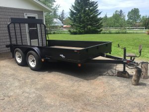

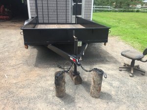

Trailer all painted.

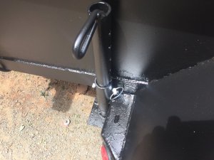

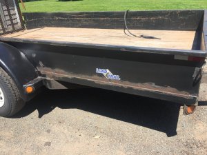

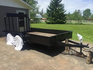

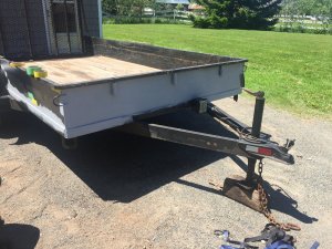

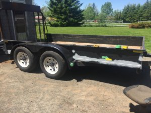

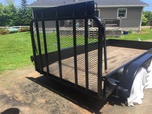

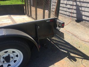

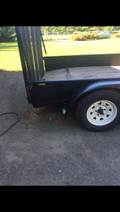

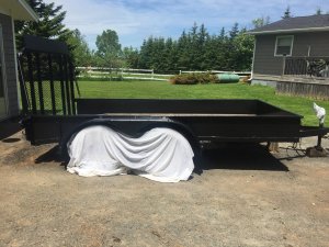

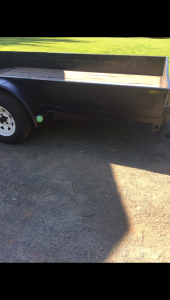

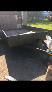

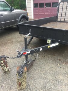

All done. Been at it for the last two days. Used a air operated needle descaler on the rusty spots. Worked great. Primed some spots, coat of black over the primed places and on some edges. Then today gave it the complete final coat.
I hope to undercoat it Ryan. Hopefully after all the work, new tires, new brakes, trailer and wheels painted and all new wiring last year, that it will last another 6 years or so. Probably will need another repaint in three years.

Made the trailer look brand new, Noel! Those descalers are great cleaning tools! They work great for cleaning slag from stick welds too. Maybe someday I will have a trailer!
Sawdust

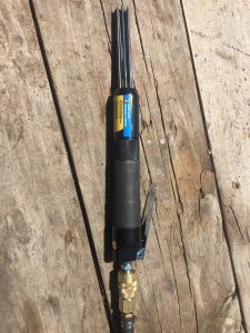

Looks like a new one now Noel great job. This project is making me feel like I've neglected mine. Can you show a pic of your descaler I'm not sure I know what your using. I see some white pin striping on those fenders :thumbs:
This is the descaler, Sawdust. It’s air operated. 55 bucks at princess auto here in Canada. The needles randomly come out. You hold it against your work and go at it. It works great. You can all most do a straight line with it. I went around the bottom of the Load Trailer decal on the side of the trailer. Hardly touched the decal.
Best to use ear plugs while using it.
